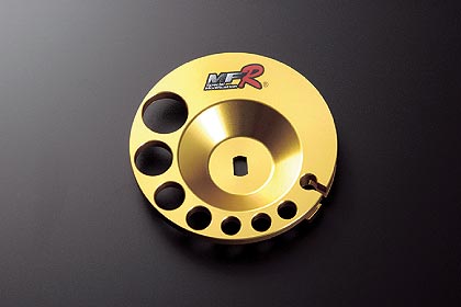

Message throttle rotor, the part that the TB end of the cable rolls over. A larger or eccentric rotor can help open the throttle slower in from closed throttle
La-Z-Link
The Infinity Q45 throttle body has a large body so it has a mechinsim on the rotor and shaft to open it progressive (slow shut, fast WOT). It would not be easy to adaptor to a Z32, but a eccentric rotor would though.
Also retuning the ecu, ie AFR TP learn values, fuel table could help.
